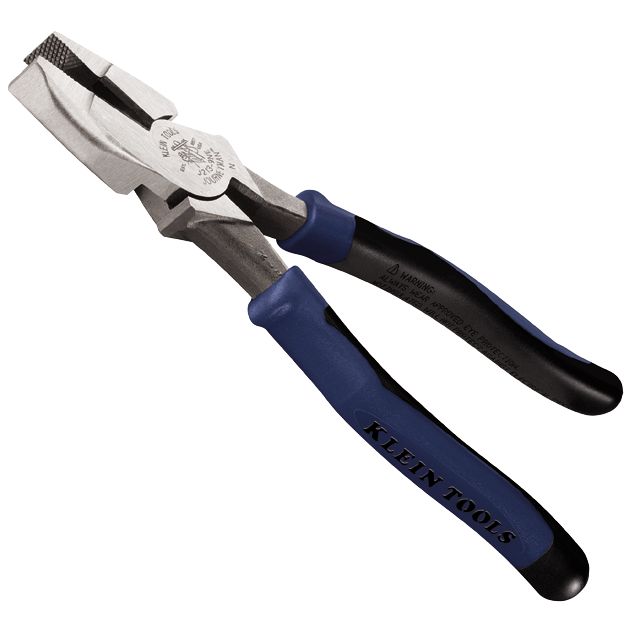

I have a technology that already prevents the fires this device protects against:
00973710000
