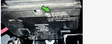

Mfg. label on A/C condenser says MCA 28.3 with 50a max breaker. So #10Cu to a 50a ocpd. Simple enough. Done. But the Homeline 50a 2pole has printing on the case that only describes #8 (or #6 ~ #2). Is this a lug restriction for all use scenarios?
I can run 4ft of #8 from breaker to the existing junction box & splice to the remainder of the run that uses #10 but I’m curious if I have an out here?

It's #8 for 60/75°, #6-#2 for 75° only. I would just use a 40 amp breaker if you already ran #10's.

35-60 amp breakers all have same terminals. I just checked out on line documents and QO has same conductor size rating as well for 35-60 amps.
I'm about 99% certain that many years ago at least the QO breakers accepted at least 10 AWG but likely even accepted 14 AWG for the 35-60 amp units? Not sure what or when this might have changed.
Then there is the QOM series main breakers that go from 50 up to 125 amps and their lugs are all rated for 12 to 2/0 AWG. Makes sense right?
I know for fact I have terminated 10 AWG and maybe even 12 AWG many times over the years for AC units, motors, and other applications that may allow higher OCPD than the general rules allow on the 35-60 amp breakers.

40 amp as I mentioned has the same terminals. 35-60 amp all have same terminals.
I've never used Homeline so I'm surprised that a 40 amp breaker doesn't accept #10's when I threw that out there. #10's and a 40 amp OCPD are common for AC units.
QO 35-60 amp breakers all have same terminals as well and mention same conductor rating as Homeline does.
I never realized the minimum conductor is 8 AWG until this thread brought it to my attention. I been using QO seemingly forever and could swear they used to have smaller than 8 AWG at one time for minimum conductor. Will be looking at some older breakers when I get the chance to see what they say.
I know I've used smaller on motors and AC unit circuits many times over the years.
