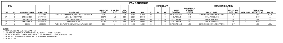

So if the breaker is 150A but the combo starter at the exhaust fan is 200A and fan HP is 60HP at 480v. what is the order/ process of sizing.
I don't see a FLA in the EF schedule but I believe you start by calculating the motor load(amps), then you size the OCPD? But there are two, the starter and the breaker.
The wire should be sized to the 200A starter/disco or 150A breaker?
