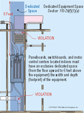

Is 110.26(e)(1) apply if I have a recessed panel and in the wall there is plumbing below. I feel it apply.
Mike’s book as I interpret it says the same on page 20 https://www.mikeholt.com/instructor2/img/product/pdf/11NEC101-1076-sample.pdf

As Mike has in his graphic the dedicated space requirement would be for recessed or surface mounted equipment. I'm not sure if a manufactured home changes anything.

The dedicated space is required to allow for adding things to the equipment at a later time. If it's already recessed in a finished wall violating the dedicated space becomes less of an issue so I could see some inspectors ignoring it. Still not code as Dennis stated.

If the pipe below in the wall is a violation, so is the top plate of the wall. Rule says it must be clear to the structural ceiling...the structural ceiling it above the top plate.

It specifically calls out foreign piping.
“ No pipping, ducts, leak protection apparatus, or other equipment foreign to the electrical equipment“

I agree with Don and the inspector 110.26 space is for safe approach of workers nothing more.
110.26 Spaces About Electrical Equipment. Access and work-
ing space shall be provided and maintained about all electrical
equipment to permit ready and safe operation and maintenance
of such equipment.

Yeah, how exactly does the concept of dedicated space work, when applying it to panels recessed in wall framing? The structural members of the framing, the drywall board, and the thermal insulation if applicable, would have to not count as "foreign equipment", otherwise there would be no legitimate application of a recessed panelboard.

I think we are getting nit picky here. My feeling is that the plumbing in the wall can impede the wiring that may be fished up from below. Not sure if that is the intent of the code....
