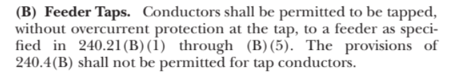

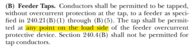

Not following the difficulty. You have a piece of #12 conductor. It has just two ends, and connections at each of those ends (assuming it actually participating in a circuit). One of those ends will be its point of supply. If that end is landed on a breaker doing the supplying, that breaker is "ahead of its point of supply."I'm struggling with the load side terminals being considered separately from the overcurrent protection. If that's true then it seems like a case with a breaker with interchangeable lugs could be viewed differently than one where the terminals that are not interchangeable. What do you think of this distinction?
