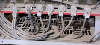

need help figuring out why my 120/208 3 ph panel is missing voltage...
each phase to ground and nuetral read 118
phase 1 to 3 = 204
phase 2 to 3 = 204
but
phase 1 to 2 = 2 volts
these readings are with loads and without loads
this just started happening today

What are the loads doing? Is the transformer on fire?

Sounds like 1 phase is open (possible blown fuse) and you are reading feedback voltages.
Is there a fusible disconenct in the circuit ?

there is a fusable disconnect that this panel is feeding... this panel is being fed from a 480 to 120/208 transformer... as far as the fuses in the disconnect, i checked the fuses and they are good

"upstream" meaning moving up the distribution chain towards the source of power; in this case- what's feeding the transformer..is it good?
I was thinking that 1 and 2 shorted together, and one of the primary fuses blew

the transformer feed is good... phases read
each phase to ground is 271
phase 1 to 2 = 471
phase 1 to 3 = 471
phase 2 to 3 = 471

these readings were taken from the legs that feed this transformer... these legs are in a panel on a breaker that feeds this transformer

How about the voltages on the secondary side of the step down transformer? Am I correct in assuming your first voltage readings were taken at the 208 panel?

think i found the short ... so my xo line in the transformer is burned and almost melted and is really loose and sparks to the touch at the tap...this is in the transformer that feeds the panel that drops 1 to 2 phase
