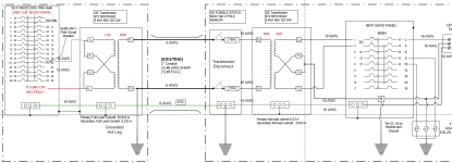

The graphic and link only consider a feeder tap. It does not incorporate interconnected sources (705 requirements) into the discussion.
IMO the 120% rule, or the "sum of" rule(s) apply between PV system disconnect and the service disconnecting means... the part in red below.
I'm simply unclear as to where the 80A PV breaker is relative to the 200A and 100A breakers.
If we're talking 2(1) or 2(2) in bold, then a 200A rated barn panel won't do.
If we're talking 3(b), then the 200A panel is ok.
I think?
The 100A breaker is "in the red" because it is "before" the 80A breaker, if it was "after"(under) the 80A, the 200A would be "in the red".
200A service breaker
|<-- conductors between 200A and 100A breakers
100A "barn" breaker
<-- 80A PV breaker
