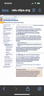

As of the 2026 second draft final ballot 230.85 is gone and 230.70(A)(1) says the service disconnect at one and two family dwellings shall be in readily accessible outdoor location
