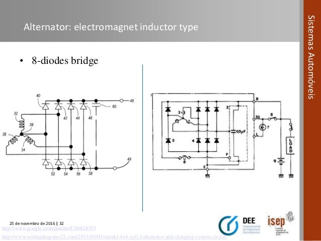

My bike's alternator has not only three stator phase diode pairs, there is a fourth pair on the output common.
Something like this:
The extra 2 diodes connected to the wye center tap apparently contribute as much as 15% extra output current, but at the expense of some added ripple.
This is described on page 3 of this article:
These "power boost" diodes are also mentioned in this patent:
