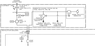

I may be terribly confused here. We have a project renovating a large ventilation building. The site will be supplied by a 1000 KVA pad mount transformer that will be owned by the utility company, I've attached a photo of the existing utility transformer, it will be larger but similar. The designer is stating that the site requires a  "a fully designed grounding grid system". This would require them to perform a a "finite element analysis".
I'm not against a grounding grid but I don't see how the code sections they reference apply, as we do not have a substation at the site. The NEC (2023) section they reference is 250.191. Now, maybe we do and I just don't understand the word 'substation'. They also reference 250.194, again this seems to be for substations and concerning the proximity of exposed conductors. Our site has a typical pad mount transformer supplied by an underground utility supply. Do these code sections apply to this installation?
