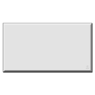

I want to install 2 NEMA 6-50Rs in a large 4 gang metal box Similar to below. I cant find a cover plate to take both receps. I thought I have seen flat plates before but I cant find them. Any sources, or ideas, or is this a waste of effort?
It used to be that P&S Sierra would do custom wall plates but Sierra has been gone for over 20 years, who if anyone still does it, have no clue.
Good feedback, thanks. At least I know its not a common off the shelf item. I didn't want to put effort into this only for someone to say "Why didn't you use this...."
Thanks.
So far, I can only suggest hole-sawing a 4-gang blank plate, or cutting and joining two 2-gang plates.
Kyle just responded to my email: "The custom plate would run well over $150.00+ and take 8 weeks."
They also mentioned a completely blank 4g plate for DIY:
I think I am just going to put them in 2 separate 4" square boxes and nipple them together. It will be surface mount below a panel. I did humor making one because I have access to a Tormach CNC mill.
