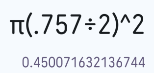

I have to pipe across a garage and then enter an attic, will #4 SER cable fit in a 1" conduit by code? I believe #4 SER is 3-#4's with a bare #4 so 4 #4's total plus insulation I hate to have to set a j box, splice than switch to SER if I were to use THHN in the conduit. The conduit will have 2 90's plus a kick. Thank you in advance
You have to use the diameter of the SER to find the equivalent single conductor size. You cannot just use 3-#4's and the table fill value for 1". The fill for a single conductor is 53%. So if your SER is equivalent to say a 750 kcmil single conductor then you use the 750 value when searching the table. For example if your SER diameter equals 1-750 kcmil and you were using EMT the 1-750 kcmil conductor would require a 1½" raceway from Table C1. Otherwise you'll need to do the long hand calculation with 53% fill.
Remember you have to treat a cable as a single conductor with 53% fill. Also pretty sure #4 SER has a #6 EGC. Based on a quick and dirty calc its super close, depending on who spec you use for cable OD. You could strip it and with individual conductors you will be well within fill.
