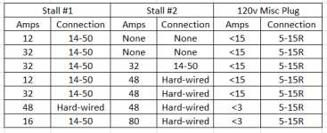

In case I do need to quantify, let me say again the sub-panel is being designed/installed to support more that just the first simple PHEV (A Pacifica PHEV). An E-Ray is coming, as is a either a PHEV or EV F-150. Too much is unclear there, and in fact I'm making many power assumptions.
So Stall #1 requires wiring capacity to 60 amps and may require a GFCI. I'd prefer to do that on one install.
Stall #2 may see capacity to 80 amps and may require GFCI as an interim. That's getting put off, but worst case GFCI wise is another NEMA 15-50 AND a hard-wired 80 amp (of which neither would be used at once) both going to stall #2.

So your worst case is 48A EVSE plus 80A EVSE plus another 20A branch circuit? In that case you'd want a 200A subpanel, a 4/0 Al feeder at 180A should suffice for the loads, though.

Yea, 2/0 SER is, at least here, rare and expensive. You can trip on 4/0 SER almost anywhere, and it's roughly the same cost. So screw it, I've already told electrician "A" I'd like to see the materials quote for 200a panel on 4/0. I'm always on the jobsite, and we don't ever require labor quotes. I ask for rough order or magnitude, but I prefer to pay T&M. I'd rather pay more if I need more to do it right, less if it goes smoothlly, and always know my service guy always made his money.
At this moment it appears like my son still wants to pull wire and breaker for 60 amp (48a EVSE) but the more I look at this the more I feel like a 50 amp circuit meets 80% of the want and 95% of the need.
