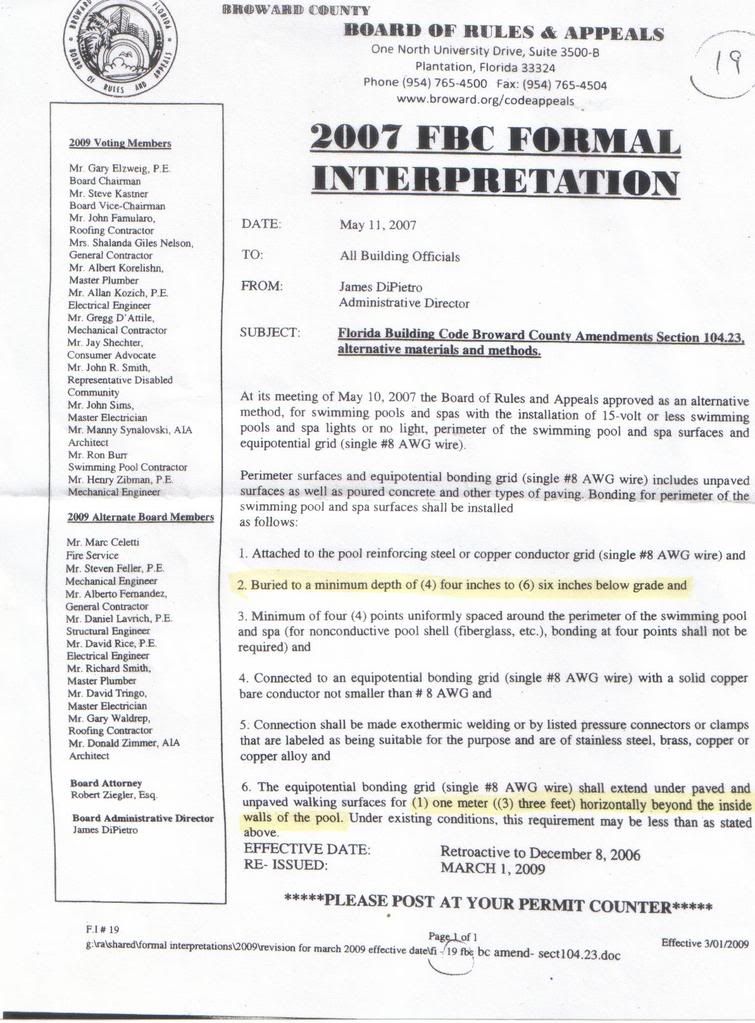

I'm on vacation in St Augistine and don't have access the the Fla regs, but all you need to do is let the paver guys grade the sand. Install a #8 around the pool 8" deep,12 to 18 inches from the waters edge. Connect this in 4 places to the pool steel along with the tails for the ladders and nitch. Don't forget the metal windows and doors if within 5' of the pool.
