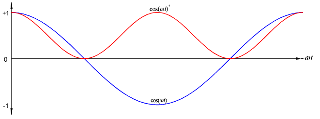

I think it is a coincidence. It would be useful though to see a plot of cos(wt) overlaid with a plot of cos^2(wt).
I've never seen this before. It's intriguing. I'm gonna disagree with you Rattus. There aren't too many mathmatical coincidences and if this image is accurate then the relationship between peak and RMS is RMS is half the angular distance from 0 to peak. Hardly sounds like a coincidence. Seems rather natural actually.

Sam, your assignment is to find some significance here, but that is not the point. The point of this thread is that you can compute the RMS multiplier without the use of calculus. Trig, difficult as it is, is far less difficult than calculus.

Smart, thanks for the plot. It fits perfectly with [cos(2wt) + 1]/2. Until I started this thread, I thought cos^2 was not sinusoidal; well it isn't exactly. Live and learn.
The waveform of cos^2 is perfectly sinusoidal... it just has a DC offset :grin:
