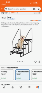

We had an inspector hit us for that on a generator install, the main on the generator was too high. I bought an RV platform step to set in front of it. Inspector was happy.

The ones for RV’s have a hand rail built into them. That’s why I chose it for the generator.
