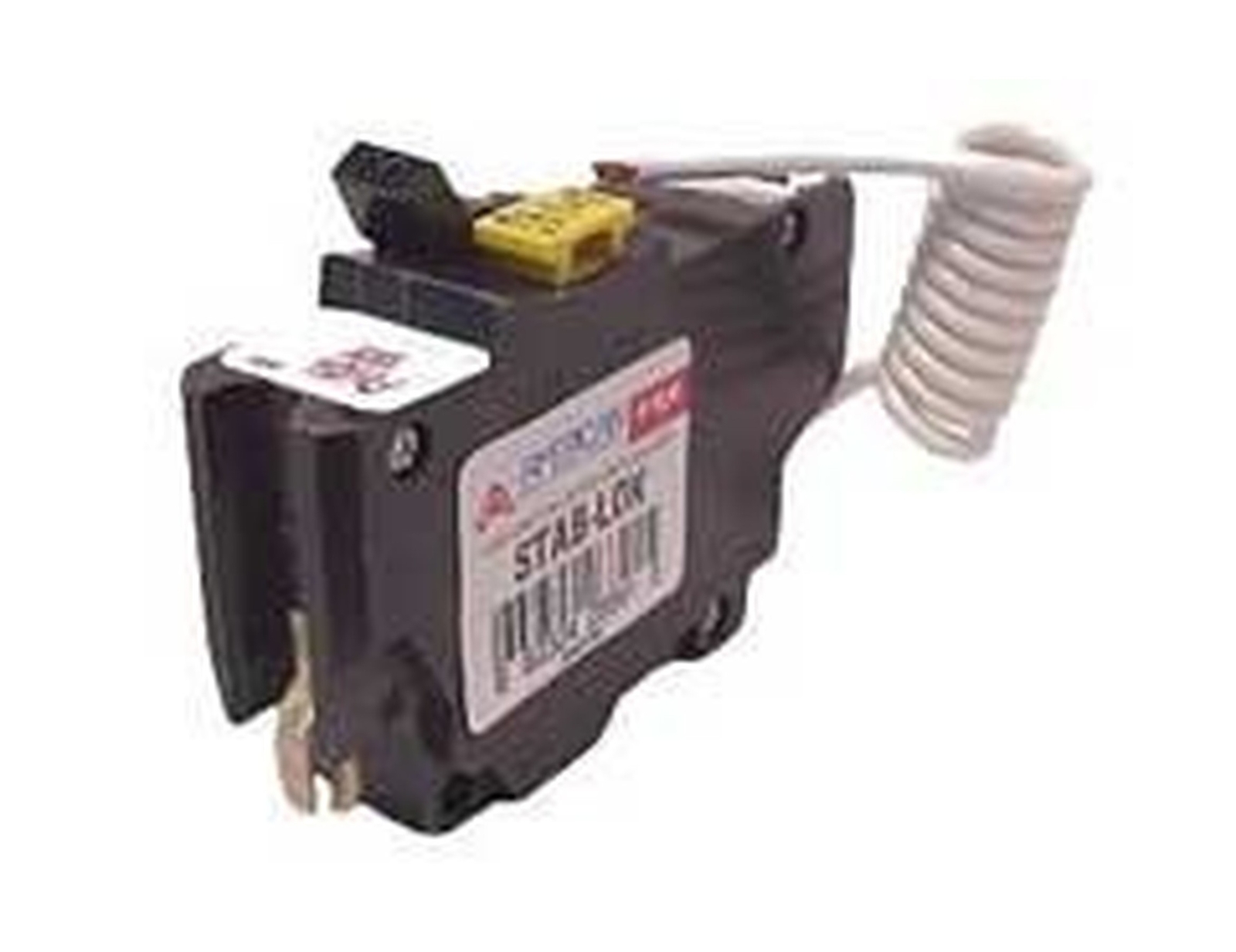

The SPGFCI's that existed before were mostly only recognized components
Picture 1 of 3
Is this a SPGFCI ?
kwired
Electron manager
NE Nebraska
Picture 1 of 3
Is this a SPGFCI ?
IDK, likely not but maybe possible?
The ones I'm talking about from before NEC included SPGFCI usually had a CT that you physically ran the protected conductors through plus the associated electronics to process what was being measured by the CT. They usually had to power a relay or contactor to be able to interrupt load being protected that often was not an integral component of the GFCI device, which likely had something to do with them being a recognized and not a listed item, but they could work with more than 20 amp circuits like the GFCI receptacles, and back then GFCI breakers were only made up to 50 or 60 amps and there were no three pole versions.
