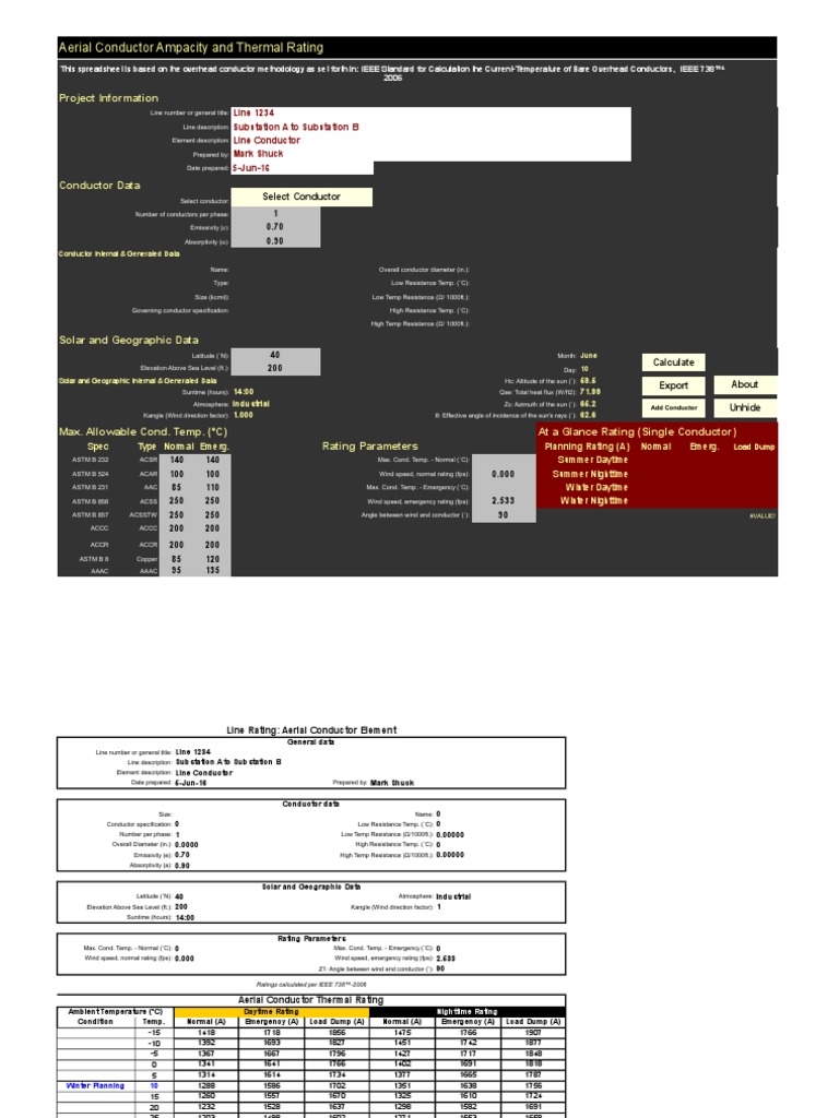

What are you getting for Bluebird at 100*C in terms of max current?
Southwire lists 1638 at 75 C. Scaling I get about 1900 at 94 C. Grinding through IEEE 738 is a lot of work. Plus don’t forget sag is going up too. Depending on line spacing that’s going to drive your limits more than anything.
