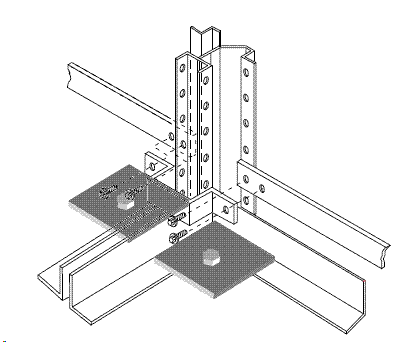

My recommendation would be to cut 4"?4"?1/4" steel plates out of strap stock, drill a 1/2" hole in the center, paint them, place tight against the inside corner of each section, and fasten down with a wedge anchor.

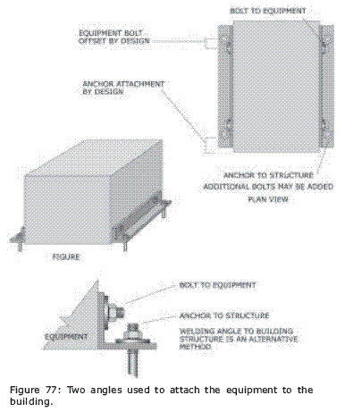

Not so sure this is a good method - the slightest shift would bend or jar the plates out of place - leaving you with floating gear. The manufaturer must have some required specific accessory clips, angles or strut mounting for the purpose - otherwise I would suggest welding the plates on. Better yet welding/bolting angles to the outside bottom of the gear. Check out that FEMA link again.
It's gonna take major seismic activity to shift gear that's pinned down at every inside corner with 1/4" plate. The anchors would likely be pulled out of the concrete before the plates give way. And if 1/4" plate won't do it, they can always be beefed up to 3/8" plate and 5/8" anchors... but I believe that to be overkill (for the area).
The manufacturer seemingly makes the anchoring provisions integral to the bottom cover, which they likely removed when the gear was ordered open-bottom. Yet I have to ask how the factory secured it to the shipping pallets???
One thought I did have is whether there is sufficient clearance to facilitate inside anchoring. Barring such space, I would go with the outside angle method. I prefer full length of gear, rather than short sections, as it just looks better, IMO. From FEMA document you linked above....
IMO it doesn't take much in a quake to get things moving. Nice sketch-up... ;) Anyway - depending on the plate - anchorning plates that are tempered are one thing.... But if you made them yourself out of mild steel IMO 1/4" would bend way too easy - if not the bracket angle of the frame. The method shown is just a large toggle - the through bolt method of just drilling the angle of the bottom of the panel board frame and using and epoxied anchor would be better.
The above method is far superior - bolts going through things, no opprotunity for slipage. Even if it were to deform it would need to draw the bolt through the angle or just shear off. Not to mention it would be much easier to do.
I don't totally disagree with your viewpoint. However, I'm basing my method on experience with anchoring this particular type of enclosure using the manufacturer's method, i.e. through the bottom cover plate. Their holes aren't even close to the corners... usually about 6?8" in from both sides... and the cover, which I do not believe to be tempered steel, is substantially thinner than 1/4".
