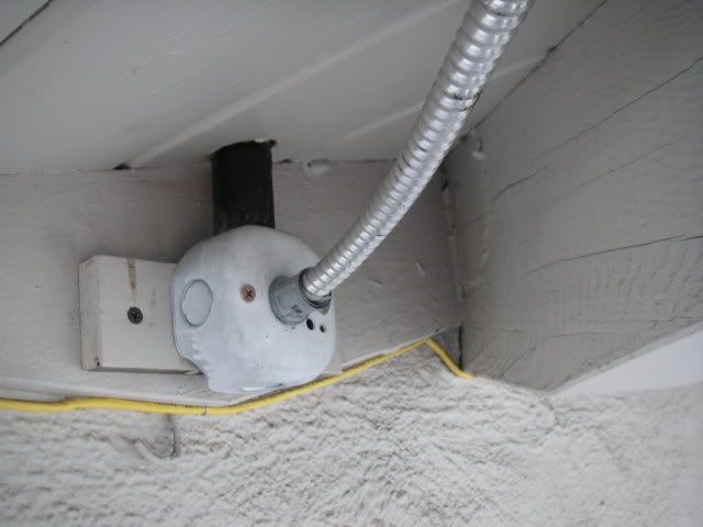

The question of whether a room could be used as a J-box jogged in my
mind the question:
Can a building be used as the cover plate for a J-box:
The J-box is for these luminaires:
What do you think?
Rex.,,
only word i say get rid of them and get proper box to support the luminaire [ both luminaire about 8 to 12 lbs a peice ]
for the junction box like that on first photo that is backward set up ughh i am suprised that someone did not get the wire nicked like that.
Merci,Marc

Yes, provided it is fed with an indoor wiring method when installed in a damp location, the box is not listed for a damp or wet location, and the raceway connector is not listed for the raceway used. 315.21(A)(3)(c), exceptions 2,4, and 5.
Violation of 314.23(B)(1)
Screws shall not be permitted to pass through the box unless exposed threads in the box are protected using approved means to avoid abrasion of conductor insulation.

The picture isn't that good, but indeed the only
visible means of support I observed were what looked like
2 x 2"+ deck screws going through the middle of the box,
so I think Chris has a bingo. Also agree on all the
other comments.
