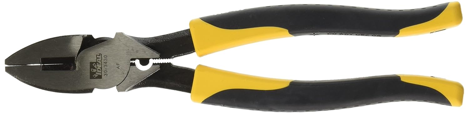

Are these crimp type connectors legal alternatives to wire nuts for solid wire?
http://www.homedepot.com/p/Gardner-...lice-Wire-Connectors-75-Pack-75-123/202522630
If so, what's the best crimp tool for working with these? My Ideal pliers (which look like this) have a crimping area, but I always considered that only for the un-insulated copper crimps you put on ground wires.
I've got to raise a 40 circuit main panel and I'm going to be doing a lot of extensions. 120 wire nuts are going to take up a huge amount of space so I'd prefer something simpler and more compact.

Those are fine however make sure they are suitable for solid wire. Years ago they used to state stranded wire only but the specs I red online do not have those restrictions.

You need to look to see if the buttsplice connector mfg has a list of approved crimp tools. Using something outside of that or non-approved would be a 110.3(B) violation.

As said above make sure they are approved for solid before using and that you follow installation instructions - 110.14(B) and 110.3(B)
Personally I would steer clear of those but if you are going to use them no matter what, at least pretwist your inline splice....
Three other better options imo are the Ideal splice line connectors (fastest)`, the buchanan crimp done with the 4 way tool, capped w/ snap on cover or heat shrinked/taped (very good but costly) or the Garder Bender copper crimp sleeves insulated w/ heat shrink (very stealthy and cheapest, but slowest).

Just get the crimp tool that's listed for use with that product.

I would never use those for 120 volt applications. Especially for solid wire. Those butt splices are for 12 volt applications, and even on those they are iffy at best.

I am going to say you are mistaken and they can be used up to 600 volts.

It does say they are rated for 600 volts, does indicate they are UL listed, does indicate size of conductor they are designed for, does not mention solid or stranded at all.

Not for 600VAC but I have and will again with 480 volt circuits.
Why not?
What would you think if you opened up a 120/240 panel that had dozens of cheap barrel type crimp connectors on solid wire?
I would not even notice it and continue with what I was up to.
I, personally, would carefully put the cover back on and walk away.
I think you are nuts. :D
You must not do any work at all in industrial settings, they love crimps and use them at all voltage levels.
Did you manage to find something from the manufacturer that states the connectors in question have a 600 volt rating?
qcroanoke already did and I have a package of Burndy 509401 22-16 AWG butt splices rated 600 volts here on my desk.
