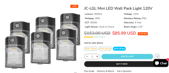

I already ordered them so I guess I'll find out
They are going inside on the wall under the garage door tracks. When you open the doors everything under them is in a big dark shadow now.
Just wondering. Not sure where they are made, but the company is in Hong Kong

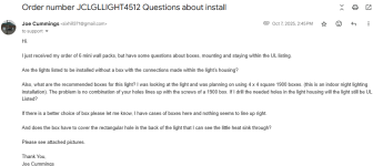

410.6 Listing Required. All luminaires, lampholders, and retrofit kits shall be listed.
99% of counterfeit UL labels originate from China.
Best practice keeps domestic suppliers liable for listing violations that void property insurance.

Ok so my Chinese Hudbel wall packs came today, they are nice and bright and the UL # checks out
Screenshot 2025-10-06 185316.pngScreenshot 2025-10-06 185424.pngScreenshot 2025-10-06 185553.pngScreenshot 2025-10-06 185713.png
But what box are they supposed to be mounted on? Nothing lines up with the factory knock out screw holes. A 1900 will cover the rectanglar hole where the wires come out, , but I'm drilling 2 new holes to make that happen. Maybe I should have ordered those Chinese Stiel Cidy boxes too

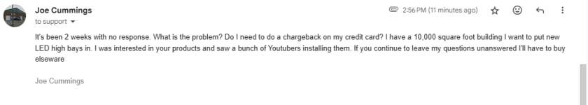

So far no answer to my questions from the supplier

Yeah, JC LGL never got back to me at all. No customer service
Its not that long ago that listing was not required in 410 for lighting.
I have more faith in an electricians judgement of a light fixture than some 'listing agency partner' thats really a empty office cube in the factory where the lights are made, or worse a fake label.
I personalty think electricians should be able to fabricate, field assemble or modify a fixture out of recognized parts following the construction specifications in the code.
I do think listing is important for other stuff like wire insulation and breakers.
