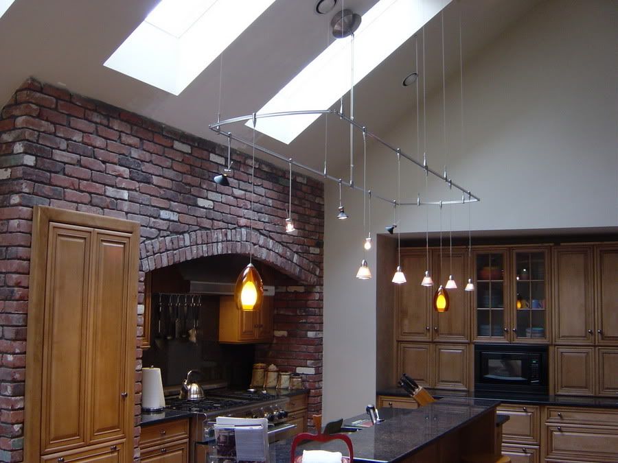

I installed a Monorail ( www.techlighting.com ) lighting system yesterday and the people just called me saying there is something dripping from the transformer. The transf is 600 watt magnetic type and is maxed out. Not something I am familiar with so I am ready for some help.

More info, the transformer has two outputs at 300 watts each (12V). Both are fully loaded to their 300 watt rating. There is a dimmer controlling the system and it is a 1000 watt magnetic low voltage dimmer. I have not seen the "liquid" yet but it sounds like a clear gook kind of thing. The good news is the transformer is 12 feet in the air over an island in a kitchen and weighs about 20 pounds. :roll: Going in the A.M. to check it out.

Well here's the problem. The dripping liquid was actually melted plastic. Anyone who has ever installed this type of system knows that all connections MUST be tight. :eek: Everything was at one point but probably after I assembled all the pieces the screw must have loosened up and I just didn't re check it. The phillips screw was loose and the connection heated up big time. Unfortunately my screw up, fortunately no major problems.
