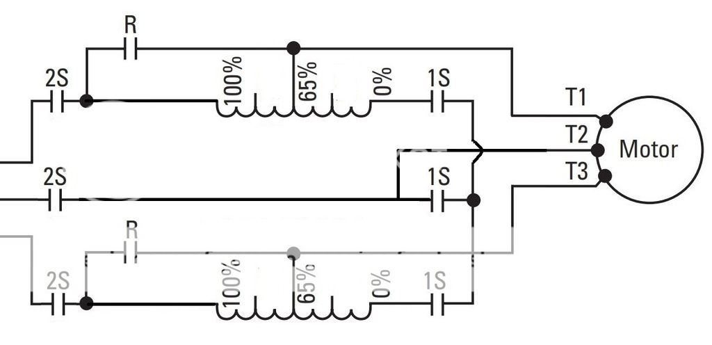

This is the power circuit. May you have a control diagram that includes the coils for the contractors and the timing relay to control the concoilsr coils?
This does seem to be a basic starter.
SG-1
1S,2S & R are the medium voltage contactors.
1S & 2S close together, this puts the lowest voltage on the motor. Motor begins to spin.
1S opens & the motor is connected to the 65% tap. Motor spins faster.
R closes & bypasses the transformer completely. Full voltage across motor.
Three step motor starter.

...1S opens & the motor is connected to the 65% tap. Motor spins faster...
If this is a modified Korndorfer starter, then having the reactor in series with the motor is only used during the very quick time it would take to open the start contactor and close the run contactor and is just used to prevent open-transition starting. It wouldn't be used as a step in accelerating the motor.
I can't say for certain, but I don't expect to find any time delay on the closing of the run contactor.

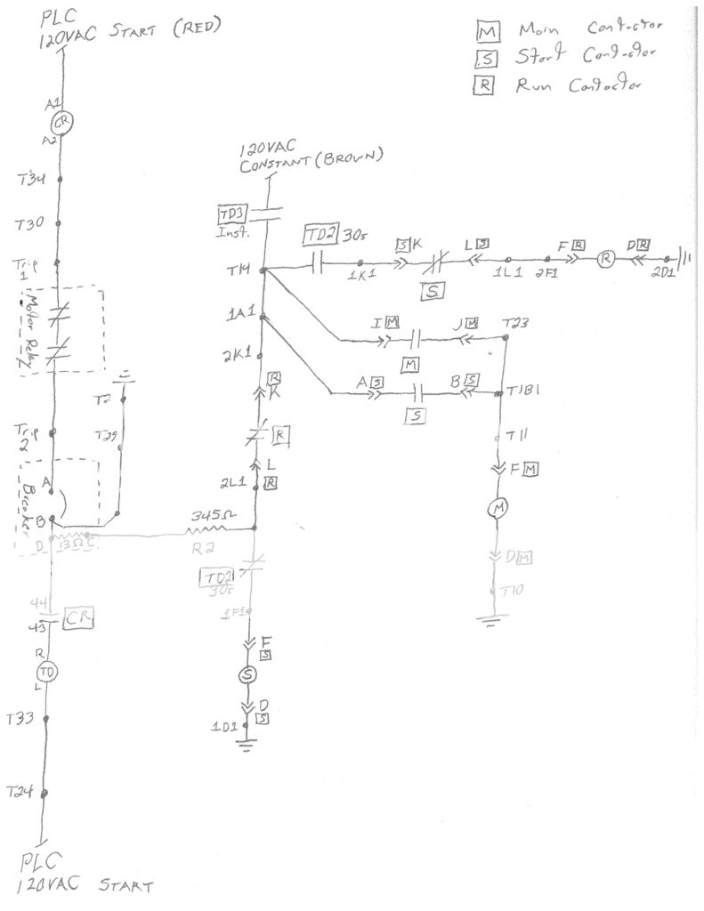

The control circuit breaker (the brown thing in the original photo) and the power resistors are still throwing me completely for a loop. It turns out neither resistor was for the economizers. One is being used as short out a current transformer (I guess a piece of #10 wire would be too cheap), and the other, see below:
This is the best diagram I've made so far of how this thing operates.
For the life of me I can't see why it's necessary to electrically connect the two halves of that control circuit through that 345 ohm ceramic power resistor.
I also still can't explain why the control circuit breaker has an 4 contacts with an internal resistance of 13 ohms. Is it some type of heater overload...?
