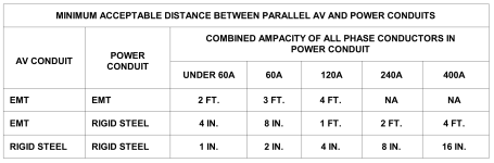

On the same notes page they have this table. Is there any justification behind treating EMT and Rigid differently? I think TIA only distinguishes between metallic and non metallic.

Well RMC is much thicker than EMT so you do have more metal for "shielding". I'm no engineer but to me this table sounds like nonsense. I'm curious to hear some other opinions.

That being said, to answer the question below, rigid conduit does provide some additional attenuation than EMT does to low frequency magnetic fields induced by currents at 60 Hz and its harmonics. This is simply due to the additional thickness of rigid conduit in providing a boundary for diverting external magnetic fields. Non metallic conduit provides essentially no attenuation to magnetic fields. Steel provides a strong attenuation because of its high "permeabiility", which can be thought of as a conductivity but for magnetic fields instead of for electric currents. Aluminum has a very low permeability, and essentially the same as free space. It only provides about a 10% attenuation, which is hardly noticeable.
.. On the same notes page they have this table. Is there any justification behind treating EMT and Rigid differently? I think TIA only distinguishes between metallic and non metallic.
The paper at the link below shows the results of testing different conduits for their attenuation of magnetic fields at 60 Hz and associated harmonics, in case someone might be interested:
https://steeltubeinstitute.org/wp-content/uploads/2020/05/GEMIVOL1.pdf
