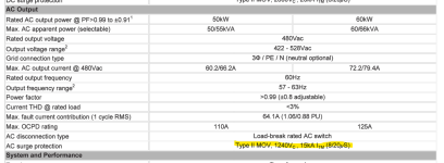

I am working with a consulting engineer to provide the 110.16(B) labeling on a project. As a part of their analysis, they shared a different take on the SCCR or "withstand rating" of inverters. The consulting engineer interprets the "AC Surge Protection" spec as a withstand rating that specifies a maximum available fault current (AFC). In the case of the CPS 60kW string inverter, this value is 15kA. Here is a link to the spec sheet.
I'm curious to hear from the folks on this forum if this is a valid interpretation, given that other posts on this thread seem to be of the opinion that inverters do not have a max AFC spec. In my specific case, I am being asked to install a current-limited, fused, AC disconnect upstream of my AC inverter combiner panel in order to keep the AFC below the AC surge protection rating of 15kA.
Assuming this is a valid interpretation and important spec to design around, has anyone used any other method (aside from a fused disco) to achieve the same level of protection?

If a PV inverter allows short circuit current to pass through it (like, from the AC side to the DC side) then basically the inverter has failed already. So denoting an SCCR would make little sense. The short circuit would happen because the inverter failed, rather than vice versa.
Very uncommon to have a rating on an inverter, unless the inverter has some kind of AC OCPD at the AC terminals.
I just don't know if it is practical. An impulse surge rating of xxkA may not have any thing in common with a true SCCR even though they use the same units of measurement.
Standard sized fuses would likely never operate fast enough to limit current to a surge device before its MOVs failed.
Given these responses, it seems reasonable that I question the interpretation of the AC Surge Protection spec as equivalent to a max Available Fault Current.
I think my engineer is taking me down a path of solving a problem that doesn't need to be solved.
A fuse cannot be used to reduce the available fault current at an inverter.
And not only does it appear that we are trying to a problem that doesn't need to be solved, it also sounds like the proposed solution wouldn't even solve it.
Also, CPS publishes an AC Site Design guide that does not mention an SCCR or withstand rating for the inverters.

Yeah, it is not standard for inverters to come with incorporated surge arrestors. Many people install surge arrestors alongside solar equipment but I daresay it isn't industry standard. The fact that this manufacturer has incorporated surge arrestors at the factory, as a nicety, does not IMO create a new limiting spec to follow. You could install a surge arrestor in an AC combiner panel and it wouldn't create an SCCR rating for the panel.
I didn't even see the 15kA spec on the spec sheet you linked to, just the description of the type of surge arrestor.
I should have uploaded the document rather than a link. It appears since my post this morning, the data sheet on the website has been updated to omit the values of the SPD. Here is a snip from the data sheet I have.
That has always been an issue with SolarEdge. Their data sheets and hardware are always changing.
