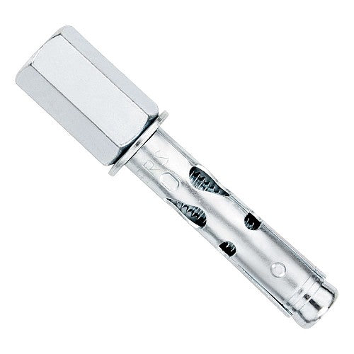

What anchors you prefer when securing conduit trapeze hangers/support in a metal roof deck (concrete).?
@infinity
Question on the anchors in the picture. Do they come with the rod coupling? The sleeve anchors I have seen the threaded stud is smaller than the drilled hole=3/8" hole 5/16" threaded and 1/2" hole 3/8" threaded or do they use Increaser/reducer rod couplings?

@infinity
do you know who makes those anchors. I have never seen them and am a fan of the sleeve type anchors. Read Head??
www.mutualscrew.com
Yes that's it thanks. I think that one of our supply houses sells a Dewalt version of these anchors.
