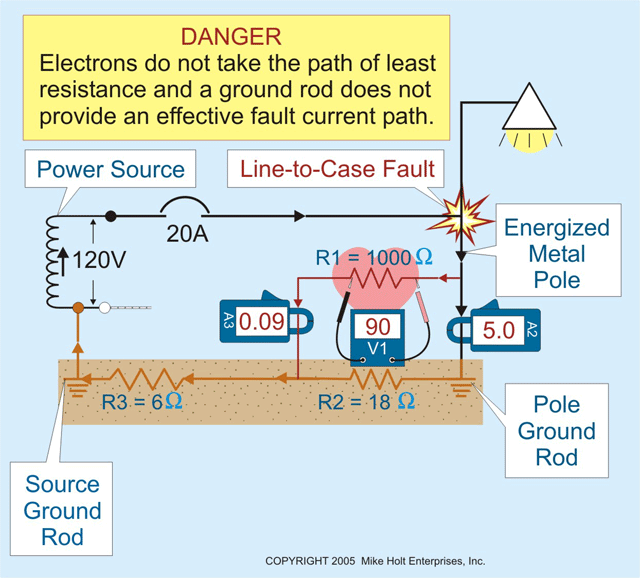

Im still studying the animation. It seems there's more to the picture than first glance. Imediatly im thinking what would happen to that fellow if there was NO ground rod. Also, picture the same scenario with a house electrical system.
First of all, if one of the conductors is intentionally connected to earth, it becomes a grounded conductor. A true neutral is only present in very specific situations. A common 120 volt system with a hot and grounded conductor does not contain a "neutral."
The person would be safer without the ground rod because the earth he is standing on would not be live. He would still receive a dangerous shock or be killed if he touched the pole and had a good path to a grounded surface via his body. The ground rod without a low impedance path back to the source elevates the touch potential as shown in the illustration.

Roger, good diagram....my point was 'what made the neutral safe. My bad grammer..LOL. Regardless of the load, its dangerous to earth until grounded..unless its at 'zero'.
With regards to the post..that's all fine, but in reality, the post is mounted with steel 'J' bolts which will have the same effect. So if true, the same problem will always exist.

The bottom line is that the pole MUST have a low impedance connection back to the SOURCE, not the ground.
Now, what utilities do is another manner entirely but under the NEC, such as parking lot lighting, the installation must include an grounding conductor, which in reality is a bonding conductor.

" If the pole is connected to a ground rod, in the event of a ground fault, the path will go to earth and not thru the dog's chain leash or person leaning on the pole."
No, never. The electrons do not want to go to earth, they want and have to go back to there source, the transfomer.
We have been taught that electricty takes the path of least resistance, which is false. If it was true, then 9 year old Victoria Quail would not of been electrocuted in Sacromento California when she touched an enegized light pole and the metal fence at the same time.
Electrons take all paths of resistance, your body has a resistance of about 1,000 ohms, in parallel with a metal lighting pole, you will have about 90 ma through your body.
Tom I understand your confusion. Much of what we have been taught about grounding is wrong.'
If it was right, then Victoria Quail would be alive today.
I have the orginal article if you would like to see it.
A low impedance fault current path is always required. A ground rod at a metal lighting pole does nothing, unless of course, it is a time and materials job. Do the math with ohms law, and you'll understand.

Re: bonding metal street light poles
TOM, look at this graphic and notice that the source and pole both have rods but there is no low impedance fault clearing path (EGC) back to the source.
You can do the math and see the 20 amp breaker will never open and the current flowing through the heart can certainly be fatal
I understand what you're saying, but are you better off with NO ground rod? The base is not going to ever be isolated from the earth. So in one manner or another, the problem exist. So, isnt the ground rod the lesser of the evils? After this, we're left with grounding the neutral at the pole or using ground fault.
TOM the ground rod or the pole being grounded through the base bolts is not a problem IF there is an Equipment Grounding Conductor in place that will clear the fault.
The ground rod will assist in dispearsing a HV surge or Lightning event, but not in providing touch potential safety.
