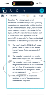

Okay, so I am trying to wrap my head around this. I am planning a service upgrade (resi, 100A to 200A) ( we are on 2020 code cycle) and I want to install a square D HOM Meter disconnect that also has an 8 circuit bus bar mainly because it is like $250 cheaper than the Milbank. Originally I had planned on marking emergency / service disconnect and running a 4-wire to a main lug panel inside the house, however, this afternoon I discovered that I have an existing 3-wire Range circuit so I cant use the meter enclosure as a SERVICE DISCONNECT and will need to install a MBP. I am trying to decide weather or not it would be acceptable to keep the enclosure, marked as Emergency disconnect not service equipment, run a 3-wire to the MBP marked as service disconnect and make all bonds inside the MBP. It feels wrong to have those extra spaces available ahead of the service disconnect, but as I look at 230.70, the first sentence says "Means shall be provided to disconnect all ungrounded conductors IN a building or structure from the service conductors". It specifically says IN a building not ON (outside) a building. What do you guys think about this? Alsop I am aware that I could potentially run a separate EGC to the Range and change the receptacle and cord but would rather not do that. Although that may be the simplest solution. ANYWAYY, any thoughts are good thoughts.

Can you use the 250.140 exception? if the grounded conductor is insulated the 3 wire feed doesn’t have to originate at the service . If it’s fed with a 3 wire se cable with bare grounded conductor, install a meter and seperate 200 amp disconnect outside labeled emergency disconnect not service equipment and make the indoor main breaker panel the service disconnect and you satisfy 230.85 as long as the equipment is listed for the application

Is it that big of an issue to get a 4 wire cable up to the range? You not required to change it AFAIK but while the work is being done it would be the thing to do. If the basement is finished that could be an issue.
