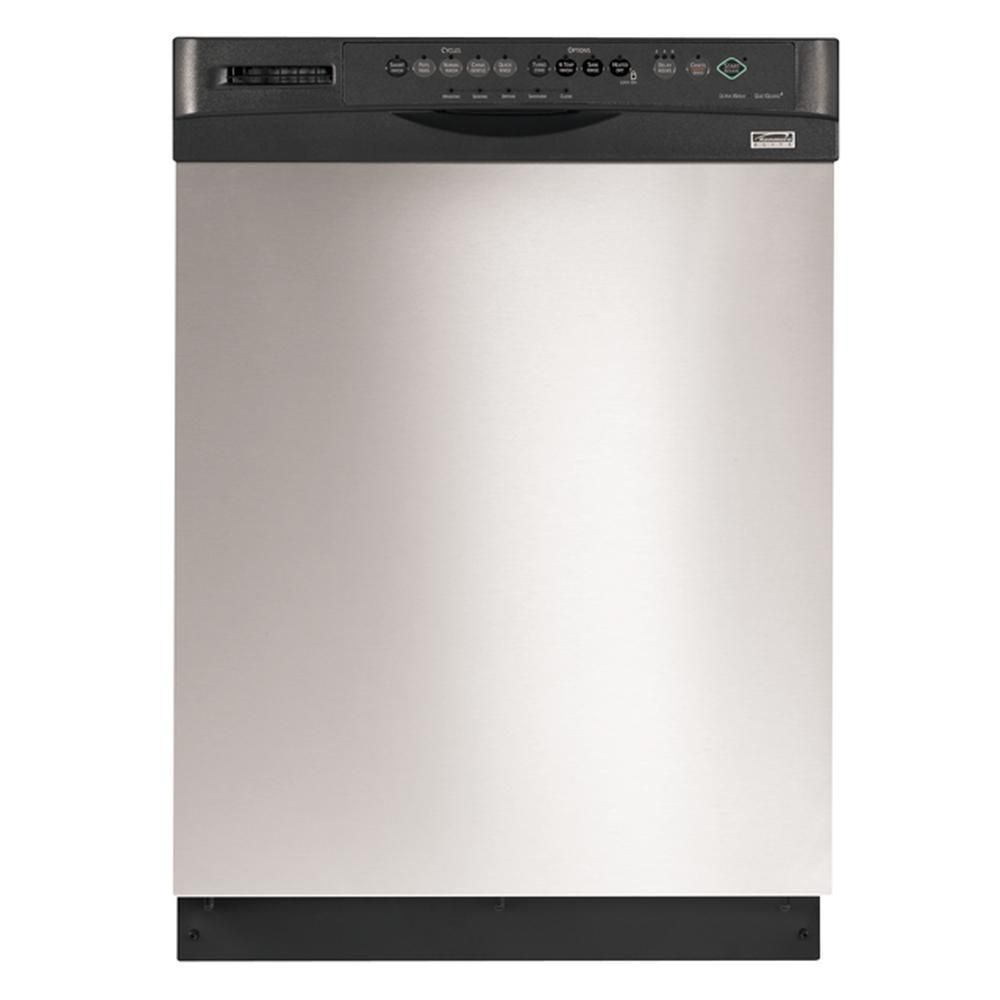

Yeah, Friday I saw a Kenmore with pushbutton controls on it. All there was to shut off the dishwasher was a pushbutton with "cancel" on it.
02216053000
luke warmwater
Re: Breaker Lock
I haven't seen that one before.
My guess is that 'cancel' means 'off' but I undestand Code says 'off'.
So, technically that one would need a breaker lock-off ord cord/plug connection, etc.

When we reference dishwashers without an off position I am guessing we are talking about dishwashers with digital buttons/controls without a mechanical knob off position?
