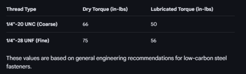

I got an array and mid end clamps I got I torque them two of them to the specs and the T bolt snapped off. Could just be a fluke with that particular Bolt but I was wondering if I eased up on it and I put Loctite, is not the principle of Torquing this so it has enough tension that the nuts don’t wiggle loose. Loctite that’s appropriate for my torque range. I should be able to loosen it enough to not worry about Bolt snapping.
Yeah, yeah I know you’re supposed to torque to the manufacturer specs
