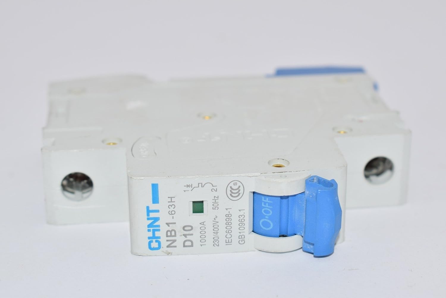

6,000A?????Update, the breaker says 50hz..![]()

Look back a few posts.6,000A?????
Appreciated, sir!Look back a few posts.
6000 A interrupt rating was my assumption.
You would think 6000 amp breaker would be just a little bit bigger, my guess is it is a 63 amp breaker
Looking back nameplate in OP says 2.5kW - should only draw 11-12 amps, 25 amp breaker might be about right if it is motor load.25 amp, C trip curve.
63 I mentioned before maybe a frame size?
That one is a 10,000 amp breakerI'm guessing model number. Most of them say "63" in the part number despite the amps being different:
Still think that is possible they are all same frame size up to 63 amps. Isn't 63 amps a common breaker size in IEC land?
I think you are right. Its probably the max frame size for 63 amps.
Keep in mind off brand Chinese products are 1 part translation fail 1 part playing by their own rules.
