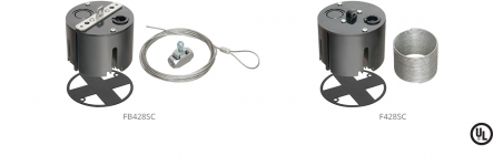

If you had both a grid(2x2) drop ceiling or a gyp board ceiling you would have two different supports for a 4" oct box with an occupancy sensor?
1. on a gyp board clg. what support would you need?? Could it just rest on the ceiling?
2. grid ceiling would you always need tbar like attached pic? Could the box be mounted right next to the grid were you wouldn't need t bar? What would you use...some Caddy support I'd say

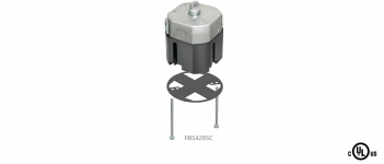

Arlington makes this specifically for a grid ceiling.
electricsupplieson-line_2729_707794190
Is the gypsum attached to a wood ceiling? If so then there are many options which you can google.
Amazing how they make that for a T bar ceiling and not being able to be used with MC or other armored cables. :mad:
I know it has a KO but I wouldn't use plastic boxes in commercial with MC.
-Hal
It can be. There is a 1/2" KO that could be used. There is a metal box that is made that it looks like half metal half Plastic.
