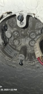

I ran into a plastic electrical box that is rated for a ceiling fan. Ran into this several times in my electrical career.
The problem is that this box has 8-32 screws. I tried using 10-24 and 10-32 screws. No luck. Wouldn't fit. Was not going to force them.
This house was built in 2001.
I don't feel comfortable using 8-32 screws for a ceiling fan.
The inside of the box was all painted (imagine that!) so I tried to wait most of the stuff out with a damp cloth. I couldn't make heads or tails out of any of the embossed writing up in the box. I did see the "ceiling fan sticker".
