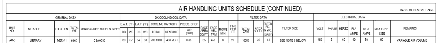

don_resqcapt19 Moderator Staff member Location Illinois Occupation retired electrician Today at 1:30 PM #22 Alwayslearningelec said: Ahhhhhhh...View attachment 2578811 Click to expand... 8 AWG copper on 90 amp fuses is code compliant for that equipment.
infinity Moderator Staff member Location New Jersey Occupation Journeyman Electrician Today at 3:06 PM #23 don_resqcapt19 said: 8 AWG copper on 90 amp fuses is code compliant for that equipment. Click to expand... Much easier to answer the question with all of the information.
