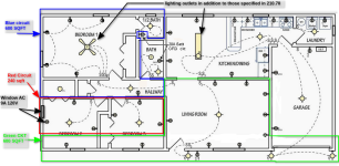

Yeah it makes it so to calculate the load on a existing branch circuit I need the square footage served, not just count the number of outlets.
Say I have a small job to wire a 200 sqft addition for a home office being built off the master bedroom , two lights and 5 receptacles.
There is an existing 15A branch circuit supplies the master bedroom and a hall.
The existing bedroom is 400 SQFT and the hall 50 sqft.
Can I tap off the existing circuit?
Is there only one? If so, then no, a 15A 120V circuit at 3 VA/sq ft can only supply 600 sq ft. But if there is more than one, you can divide the 650 square feet between them.
Interestingly, in the 2026 NEC Second Draft, the minimum unit load in 120.41 (renumbered from 220) is 2 VA/sq ft, reduced from 2023 NEC 220.41's 3 VA/sq ft. But 2026 NEC 120.13 still specifies that the number of branch circuits be based on 3 VA/sq ft. So for 15A branch circuits, you'd still need one per 600 sq ft, but each branch circuit could cover up to 900 sq ft.
Cheers, Wayne
Yeah just one, in that case it requires a new AFCI circuit.
Yeah then if you really look closely dividing up the square footage to the way a house is actually wired could get quite a bit more complicated than just counting up outlets. Fortunately most inspectors don't look that close and just take your word for it that you evenly divided up the loads.
Here is generic SFD floor plan for a quick example and I drew three 15A circuits, call them red, green and blue, and they serve the areas (in square feet) marked in the rectangles, I made the red circuit smaller due to a known fixed window AC, if the small bedrooms 2 & 3 are divided evenly the green circuit may seem to serve more than 600 SQFT.
For arguments sake, why would you make the red circuit smaller? If the general circuit is only calculated using the 3va per sq ft, then you don't have to worry about the load on it. Correct? or does 220.14 no apply since you added a fixed load such as an AC or fixed electric heating? Doesn't the addition of a fixed load mean the circuit is no longer general use?
