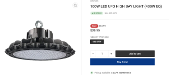

A customer comes to you and want's four 100w lights installed in a boiler room. There is only 240v available. There wouldn't be any materials specified and none were here. It's completely up to you to come up with how to do it and with what. You quote four LED high bay fixtures with installation. The farthest thing from my mind would be cobbling up some kind of series/parallel arrangement with regular 100w light bulbs. That would be DIY for sure.
If you want to learn how resistors work in series and parallel arrangements and the calculations use actual resistors, not something that exhibits resistance. If I saw that question on a test I would think it was a trick question.
