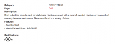

No grounding lock nuts or grounding bushings? Looks like a concentric knock out. I know the enclosure will be bonded in the switch, but shouldn't there be bonding bushings and grounding lock nuts? Even on the chase nipple to the meter?
A chase nipple is not a raceway
