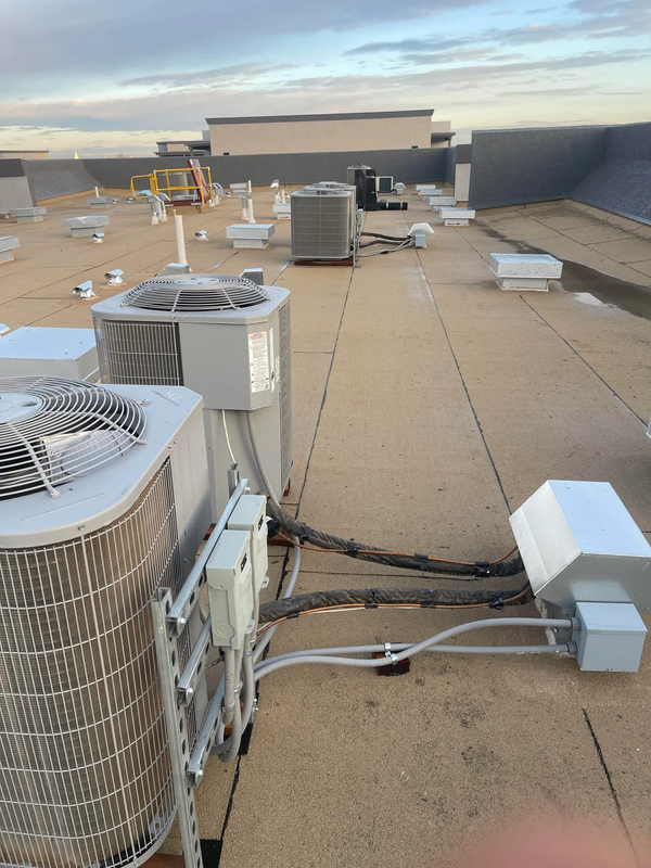

Condenser mounted disconnect switch
I agree with Augie. If you cannot remove the panel or access interior components then it's a violation.
Thank you for your responses, I appreciate it.
As a follow up, the electrician may not have enough clearance (3') on this tight roof in front of all the disconnects if they mount them directly on the condensers.
How about using a subpanel, on the roof, within sight of all the condensers.
Ever seen that done before? Code compliant?
