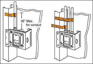

In commercial rough out (i.e. metal framing) we use Caddy CS812 Screw On Conduit Support, listed for wood or metal, to save time and forego an offset at the box, running the conduit straight up...
(image is linked to product page)​
Assuming you are looking at offsetting 8" at the top plate to get the "poke through" in the center of the wall cavity, I have to ask why you don't just run the conduit straight up through the top plate so no bending is required?
