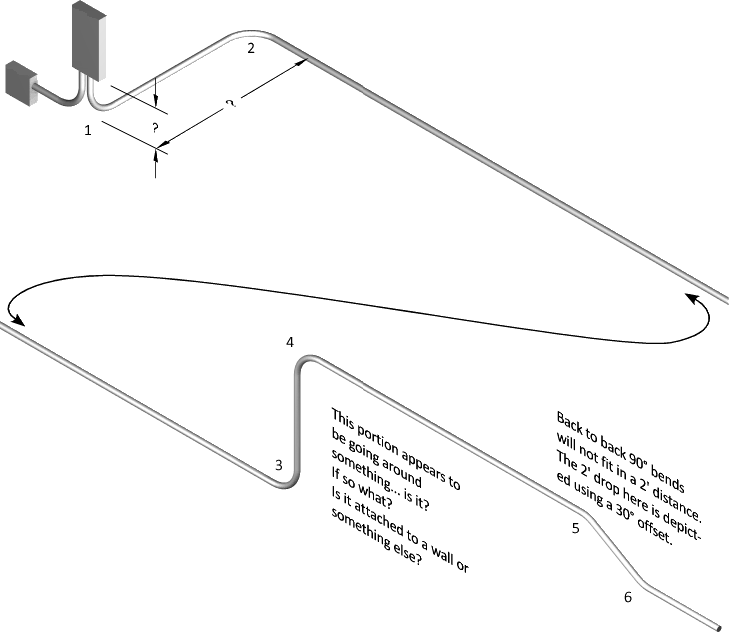

I would like some suggestions please on the best fittings to use in order to make this run and pull as easy as possible. The scenario is as follows :
From an existing 18" X 18" junction/splice box , I need to transition over 3 feet and 90 up about 30" into the bottom of a 225 Amp Service Panel(Nema 3R) of which will have feed through lugs. Back out the bottom, 90 straight back to another 90 and run the distance of about 48 feet horizontally along the edge of a concrete slab(8" thick) 90 back up again for an 8 foot vertical , 90 yet again to another horizontal run of about 18 feet, down 90 about 2 feet and yes transition yet again to another horizontal run in air (supported with either 6" x 6" treated posts or galvanized pipe secured at the base onto a concrete pad with cradle supports beneath the conduit) for a 12 foot span through the building wall into an existing 200 Amp subpanel. The area where the conduit will be in the air between buildings is not accessible by equipment so there is no worry as to the height, just stability of the supports.
The wiring will be 4 -#300 Aluminum conductors pulled through 3 inch diameter schedule 80 PVC . The area will be wet at least 95% of the time and I was intending to use type "XXHW" for the moisture resistance characteristics due to condensation buildup within the conduit. It will be susceptible to both cold and hot water overspray conditions on a regular basis.

If I counted correctly you have 5 90's and it is less than 100 feet. With that being said what about a type "C" conduit body, so you could pull straight threw.
peter, in response to your question "Why do you have to drop down 2' for the open air part." I have to get below the soffit area of 2 seperate buildings that are at different heights and make an offset to transition from one building to an existing opening directly through and into the existing 200 Amp panelboard the boss wants to reuse.
XHHW is what I used. The problem is, 3" LB's and fittings like that are not going to be rated for 300 AL wire. Regardless, you will obviously need a couple pull points.

I get about 93' of run and SIX 90? bends.
Since this is PVC, I would caution against using the factory bell ends. Cut them off, cut off the bell part and use the rest as a coupling. But that's beside the point.
You could possibly get by with one 90? bend: From the top side of the 225 Amp panel, run your tube straight to the wall, place your 90? IN the wall and it hopefully will end right at the side of your last panel.
But wait! there's more. If you replace the 90? with a pair of say 15? bends you can create an offset again into the back of your panel.
Placing two 90?s immediately adjacent to one another [one connected directly to the other] in different planes will make it impossible for a standard flat fish tape to go through since its plane of bending is set by the first bend. But that's the least of your worries.
Why do you have to drop down 2' for the open air part. Can't you use some sort of supports or stantions to support it in the air 2' higher? Or at least replace the two 90?s with a 22 1/2? offset. If any of this is underground or could be, then a couple of sweeps and a straight run should suffice.
But note: I have no idea of your actual situation, obstacles and whatnot so I don't know why you have all those ups and downs.

Nevertheless, the following image is a 3D isometric view of how I interpreted Krim's description...
Krim didn't provide distances for the first two legs of the long run—which could make a major difference as to what parts go where—nor did he provide a heading for subsequent turns. Structures in the immediate area can also be of importance. A simple [plan view] layout diagram/sketch would be nice.
BTW, I like Laszlo's suggestion on using CLX instead. Perhaps a messenger cable for last leg will suffice.

WOW Smart $ , What program did you use to draw that up ?
I could definitely use something like that for laying out things for a better perspective. Other than a couple of the actual runs needing to be flipped over and some other minor details that is darn close ! I was trying to come up with some ideas to keep from having more 90's at points 5&6 and the 30 deg. offset looks like a good possibility. By the way the missing distances are aprx. between points 1&2 ~3-4 ft, pts 2&3 ~48 ft, pts 3&4 ~8 ft, pts 4&5 ~18 ft, and pts 6 to end wall face ~12 ft. If point 2 were flipped and connected at point 3 and Point 4-5 would pivot towards lower left . This will be exactly what I have .

I used TurboCAD 14 Pro. Judging from your earlier comment...
"Sorry guys I'm not much of an artist nor do I have any CAD experience. What is an isometric drawing anyway, a rough sketch ?"​
...learning to use it to the degree of generating such a drawing will probably take more time and patience than you would be willing to depart with. I have ten years of "practice" through ten program versions under my belt.
