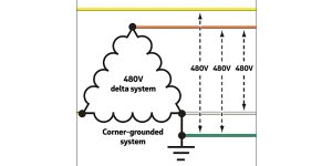

Sometimes images of a corner grounded delta system help.

Ungrounded Conductors of a corner grounded delta system can be any color other than white, gray or green. typically:
White (grounded conductor) Red and Black ( ungrounded conductor).

Biggest problem is some don't realize you can ground any conductor of a system and it then that conductor is at ground potential.
NEC as a general rule requires the neutral (when there is a neutral) to be the conductor that is grounded. When there is not a neutral that is when some people get confused on why/how you can ground a "phase conductor".
