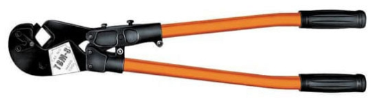

Need help, I have no experienced with permanent crimps,
Inspector has asked me that I need to permanently crimp my ufer ground ( concrete encase electrode) 4awg bear copper solid, for the the service that’s going to my disconnects, and does not want split nuts for it,
-What’s the correct crimp tool and dies information, I haven’t been to find any clear information to educate my self on this topic
Or this is buying the same brand crimp tool and crimp connectors?
I see tools like this on Amazon but I not sure if this tool if use with the c-tap connector
Any info is greatly appreciated
Something like this is what I use

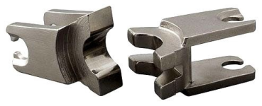

Me too, just mine is red. I like that green color 💚. What crimps to you use? I usually use the Blackburn CF series like a CF22, but I think you need to go up from a BG die to a KK to do like 2 #4. I've never bought the KK die as the BG seems to work even for the larger ones and I don't really care cuz it's all just for show anyway.
Most those C taps I've encountered use the same 5/8 die that "insulinks" use from a tool like the one ActionDave posted.
AFAIK most of them are not listed for grounding so keep that in mind. They can still be used for connecting bonding jumpers to a GEC though but to splice a GEC they need to be listed for grounding, something tells me the ones actually listed for grounding need a different crimper/die though I never encountered one.

OK. So always learning. Turns out the crimp I posted is not listed as Grounding and Bonding. The two Code sections I could find that require that listing are splicing the GEC and GEC taps. I did find a ton of Ilsco crimps that meet UL467.
And it looks like the crimp with dies on a Manual Crimper (like the Greenlee one shown earlier). I have one Greenlee version and a way older Burndy one with wood handles.

I remember looking up this kind of information some time ago, Yes there are devices listed for grounding, that my supply house doesn't stock which tells me there is either nobody using them for such or nobody actually enforcing use of the proper devices. The ones they did carry do call for dies O or BG like what you mentioned and I have that crimper. But at the time I was investigating this I couldn't find any listed for grounding that you can use those dies on. I think I was looking at Burndy then as that is what I use for other such crimp on devices that this tool can use.
Amazingly (at least to me) you can get these on Amazon. With that said, I'm not going to stay up at night about using T&B C-taps I showed earlier.
