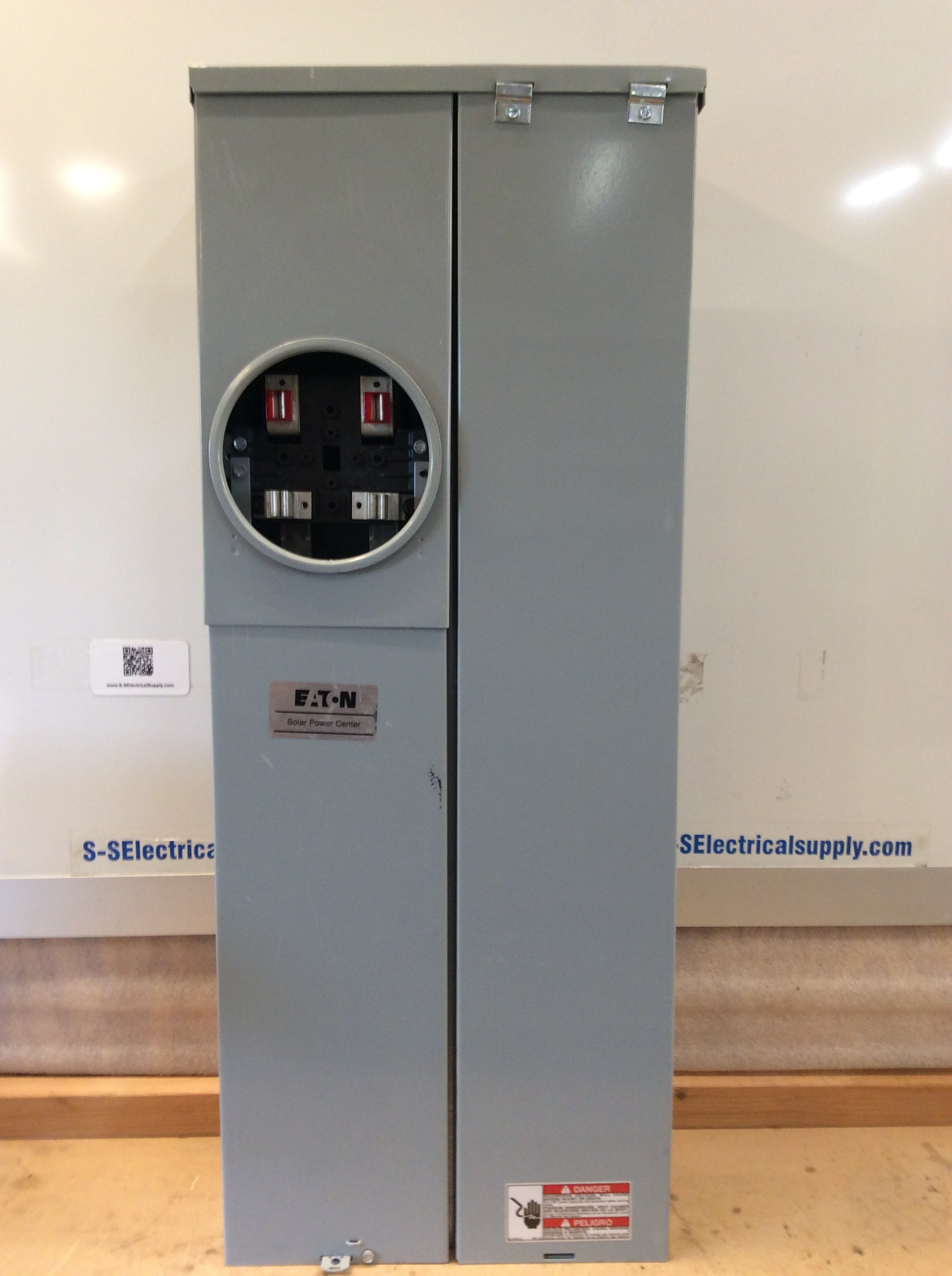

few minutes of surfing I see this, which looks like what the OP has...maybe those jumpers are installed correctly even if it doesn't look like it...you have to scroll down about 8 photos or so to see the main and jumpers...

Hi tthh,
Thank you.
You are correct. I discovered the same thing yesterday, drove down to a supply house and viewed an identical panel.
Even the main breaker in the other panel has that small tilt forward.
So an adjustment on the main buss assembly could be the solution.
