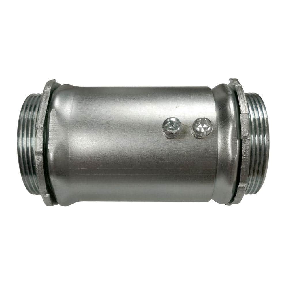

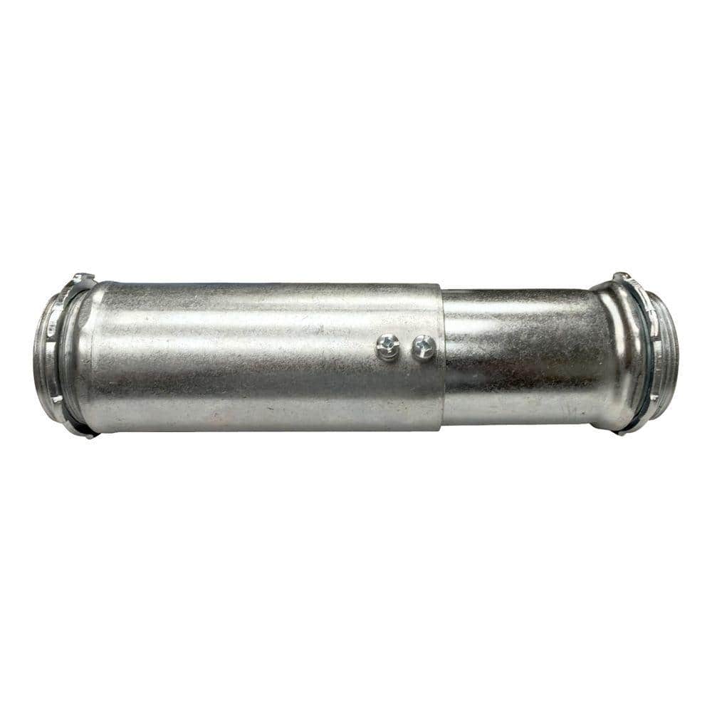

I just had an idea: If the boxes are close enough, a 2" Chase nipple could be inserted from inside one enclosure, two locknuts spun on, inserted in the second enclosure, and the last locknut or bonding locknut spun on.
Or, two of whatever the PVC version of a Chase nipple is called, glued into a coupling cut to fit the gap. If they're too long and butt inside the coupling too soon, cut each of them down a bit.
