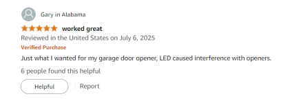

Here are a couple links.
I bought one from the first link. I just installed it, and it worked properly.
Many thanks to everyone for your responses.
