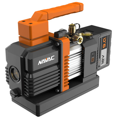

Vacuum pumps is main thing that possibly is needed that isn't battery operated.
Wouldn't be surprised if there isn't some of those around that are battery operated, though I can't recall ever seeing one.
