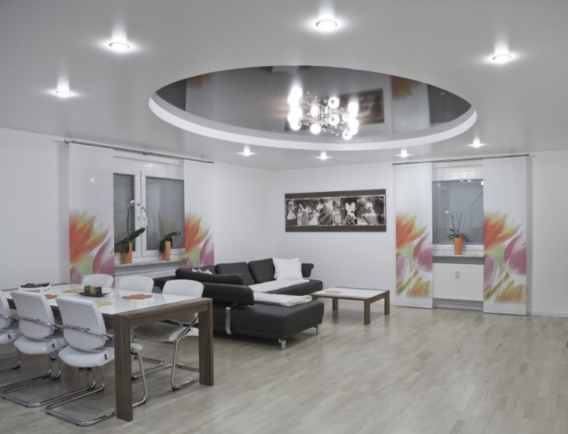

Hmm. This website says even plaster and lath can be suspended ceilings.

It's installed like any other ceiling, wall to wall taped and painted.
Then, in my opinion, that would be a structural ceiling, especially in how it would affect our work.
The OP had asked about a drywall ceiling attached to trusses. Is there any doubt that's structural?
I believe a ceiling can be suspended, then rendered structural if it's finished like a drywall ceiling.
Can a structural ceiling be suspended? I don't see why not. They need not be mutually exclusive.
I remember walking on the old metal lath and plaster suspended ceilings. Typically 1.5" black iron hung using heavy wire with 3/4" iron in between the black iron, and the metal lath tie wired to the 3/4" iron. The whole assembly suspended from the actual structure with #9 wire.
I think the code should replace "suspended" with "lay-in" as this is a common question.
