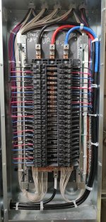

The panel is at least 3 1/2" deep. With or without cable ties if a sparky can't keep the wires an inch away from the screw holes he's doing hack job.
Guess you've never done a 66 space panel where all the wires come down from the top? Get's pretty crowded in that small side channel.
I wish someone would make larger boxes for residential use, not all resi panels need to fit between the studs.
Nice work Larry, and this is kind of to the point I made earlier that there is no reason why the wires need to be close to the screw holes other than being sloppy and/or lazy. The one exception may be if you're using all stranded conductors but then the installer should spring for a bag of cable ties. View attachment 2581666
LOL That's a commercial size 3 phase panel. Let's see how that all works out in a smaller 13" wide 66 space panel.
