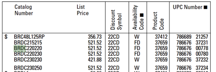

Let's see. From Eaton's official "list" price list:
So they're asking about twice as much for the identical breaker without clip, vs. clip.
And weirdly there are certain combinations of breaker sizes only available in one or the other line.
So now that the clip is gone, will they equalize the price?
BRDC220220 $521.52 22CD FD 37659 786676 00778
BRDC220230 $521.52 22CD FD 37659 786676 00780
BRDC230230 $421.88 22CD W 37659 786676 37232
Note the codes are Factory Warehouse and Mod, following by a speed of delivery code.
VIF Verified In Field

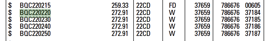

I ordered a BQC230250 from a major chain, the picture shows a rejection clip.
What arrived had date code 250824, kAIC actually stamped into the case at 10k, and no evidence the clip idea ever existed.
Ding dong the clip witch is dead. A universal breaker for 1/3 the cost of BRDC230250.
It's going to be hard for breaker resellers to dump old BRDC stock now (listing for $80-$120 each online).
Or maybe someone smart is going to start listing BRDC230250's for $50 but actually supply BQC230250 and keep the difference.
